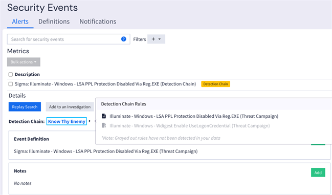

  • On the alert detail page, the active detection chain is shown at the top. Click the detection chain name to see the list of events from the chain. Any rules that have been triggered are highlighted, while those yet to be detected are grayed out.
    Active detection chain pop up viewed for a security event.
    Hint: Use this view to ensure that all relevant Sigma rules are enabled. If you have a triggered event from a detection chain, make sure that you have enabled all other listed rules in that chain to receive best coverage and accurate risk scores.
