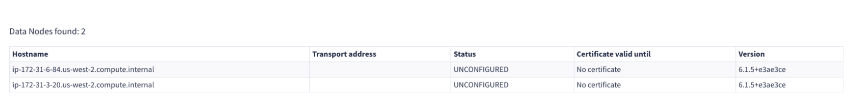

  1. Navigate to System > Data Nodes > Data Node Migration.
  2. Wait for all Data Nodes to be discovered. They should be listed with a status of UNCONFIGURED.
  3. Click Next  when all nodes are discovered.

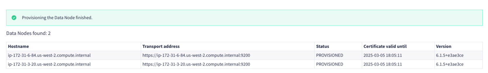

Provision Data Nodes with Certificates
To provision Data Nodes with certificates:
  1. Start by expanding each Data Node in the Graylog interface by selecting the node to see per-index information and compatibility.
  2. Click the Provision Data Nodes with certificates button.
You should see the following success message. Note that the Status field says Provisioned.
