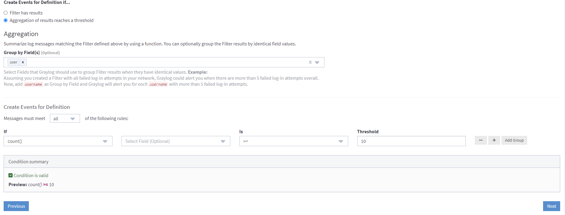

Create an Aggregation
Since you want to aggregate on your events (to see if you have more than 10 messages in 10 seconds), select Aggregation of results reaches a threshold under Create Events for Definition if....
To be able to find how many failed login attempts there were per user, you need to add a pipeline to incoming messages. The pipeline will extract the user name and store it in the User field. Every message with a failed login has a User field. Enter that field in the selection Group by Field(s).
Finally, add an aggregation rule: If count() is >=10.
Aggregation settings grouping by user_name, with a rule that count() is at least 10 and a valid condition summary.

  1. Added a stream to minimize the messages you need to filter on.
  2. Inserted a query to filter the logs down to only failed logins.
  3. Grouped your logs so the aggregation is applied per user.
  4. Added a rule: only raise an alert if the count is more than, or equals 10.
