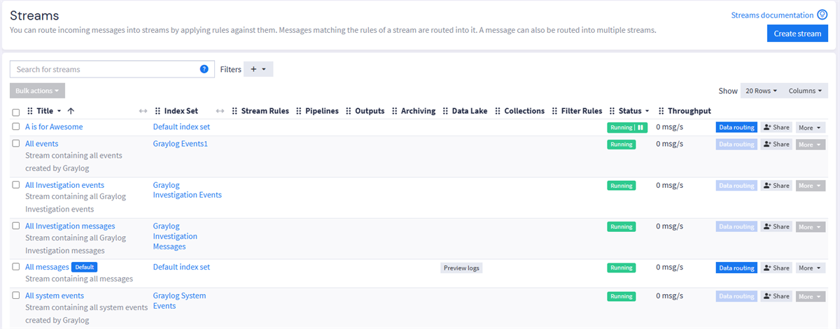

Manage Streams
You can manage existing streams on the Streams page from the top-level menu.
Table view of streams with associated data on the Streams page in Graylog.
The Streams page in Graylog is a central hub for creating and modifying streams. Use the View controls above the table to switch the displayed columns to match the task at hand. Select Routing to trace how messages reach a stream and where they are sent next. Select Performance to identify streams with heavy or slow processing. Every view includes the stream's title and index set, as well as the columns listed for the Default view.

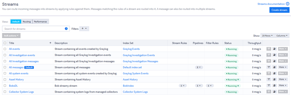

Default View
The Default view lists the core attributes of each stream:
  • Description: Shows the description entered when the stream was created.
  • Stream Rules: Displays the number of stream rules attached to the stream. Expand the row to view information about specific rules.
  • Pipelines: Displays the number of pipelines attached to the stream. Expand the row to view the specific pipelines.
  • Filter Rules: Displays the number of data routing filter rules attached to the stream. Expand the row to view information about specific rules.
  • Status: Displays whether the stream is Running, which indicates that the stream is live and may have data routed through it, or Paused, which indicates the stream is no longer active.
  • Throughput: Shows the rate at which messages are processed and ingested by Graylog in this stream.
