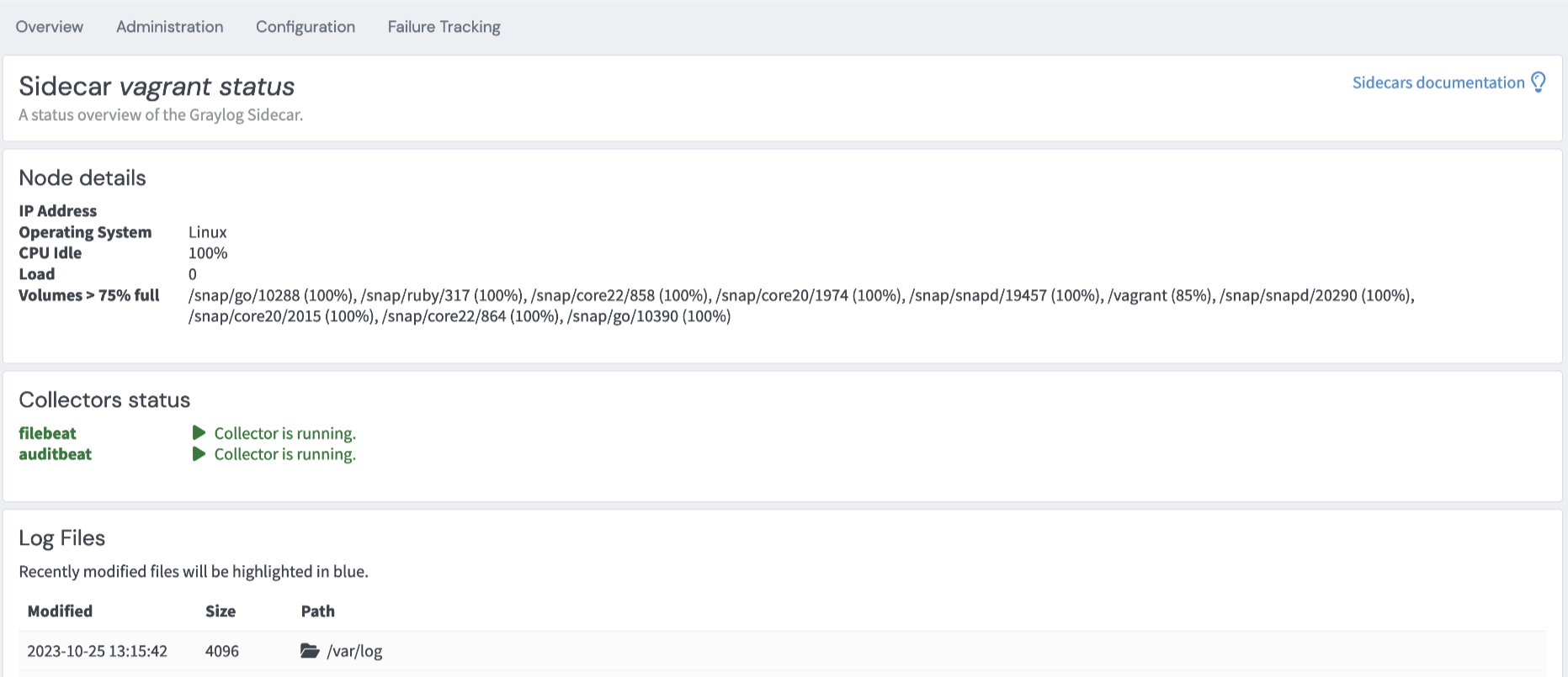

After the initial check-in, the host appears in Graylog under Sidecar Overview. To confirm the Sidecar has been registered successfully:
  1. Navigate to System > Sidecars > Sidecar Overview.
  2. Locate the host by its configured node_name.
  3. Confirm the Last Seen value is recent.
  4. Verify the operating system, Sidecar version, and installed collectors display correctly.
  5. Ensure the tags shown in the UI match the tags defined in sidecar.yml.

  1. Navigate to System > Sidecars > Manage Sidecars.
  2. Select the host you deployed to.
  3. Confirm that the expected collector is running and that the applied configuration name matches the configuration you assigned.
  4. Check your Graylog input to confirm logs are arriving.
