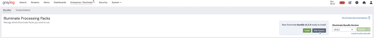

1. When a new Illuminate version is available, you will receive a notification in your Graylog interface.
2. Navigate to the Illuminate page by selecting Enterprise > Illuminate.
3. You will see a notification at the top right of the screen indicating that a new Illuminate bundle is ready to install. You may select Install from this menu, or you can navigate to the Install Another Bundle link located beneath the Illuminate Bundle Version drop-down menu. (If you do not wish to upgrade at this time, you may select Skip Version. This will also remove the notification from your top menu.)

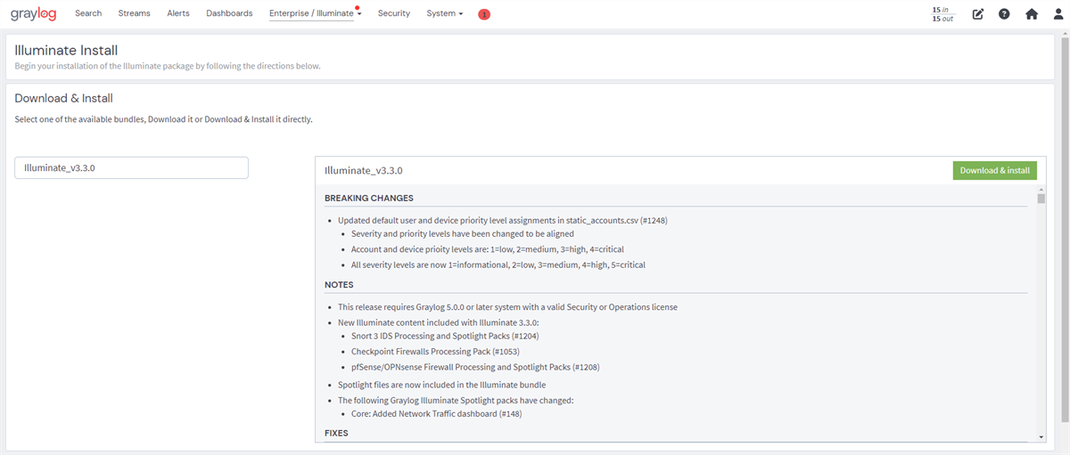

4. On this menu select the Illuminate version you wish to install and click the Download & Install button. (You may also wish to preview the available versions by selecting them from the side navigation and reviewing the attached changelogs.)
5. Confirm your installation by selecting Confirm on the pop-up menu to begin the installation process.
