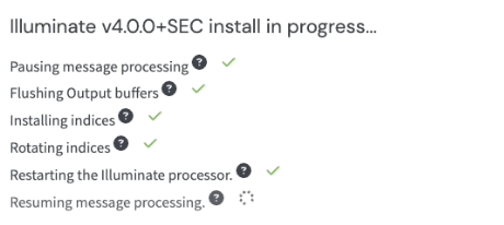

5. Once you have initiated the installation, you will be presented with a page that breaks down each individual step in the installation process and its status. As processes are executed successfully, a green check mark will appear, and the next process will run. If an error occurs during installation, an error message will appear so that you may investigate the cause. Please note that the installation process may take several minutes depending on your environment.
6. When the installation process is complete, you will receive a notification that Illuminate has been successfully installed.

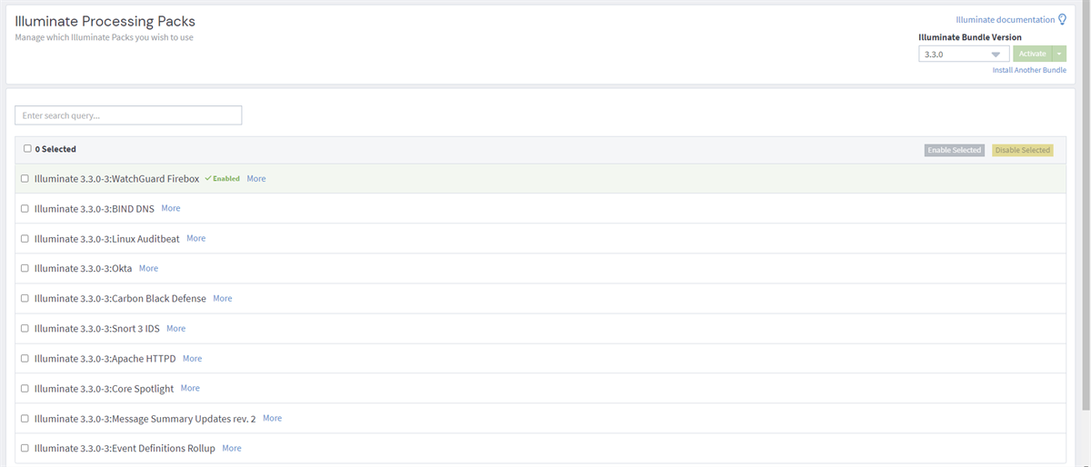

After the Illuminate installation is complete, navigate back to Enterprise > Illuminate for a list of Illuminate packs that can be activated on your Graylog system. You can enable the following Illuminate packs from this menu:
Activating Illuminate Packs
1. Browse through the list of packs provided by Illuminate using the controls near the bottom of the page, selecting any packs you wish to activate.
2. When you have selected all of your chosen packs, click Enable Selected on the upper right of the Illuminate packs list window.
