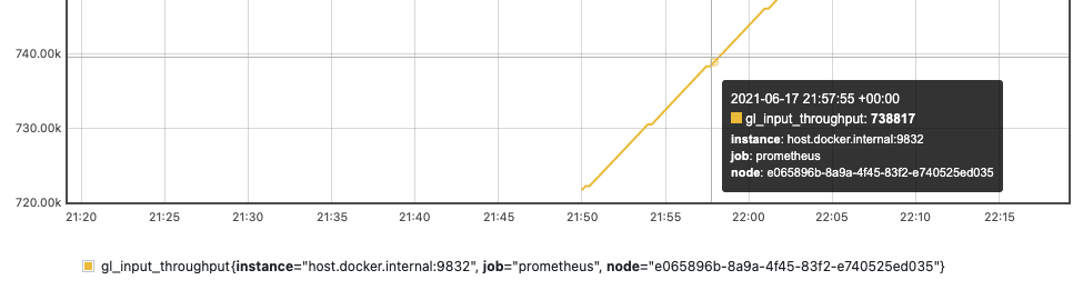

to clearly indicate that the metrics originated from Graylog. For example, the metric name gl_input_throughput.
All metrics are automatically assigned a node metric label, which contains the Graylog Node ID where the metric originated from. This can be useful for visualizing the same metric across Graylog nodes.
Many metrics are exported with a consolidated name, which allows breakouts by labels to allow easier visualization of metrics.

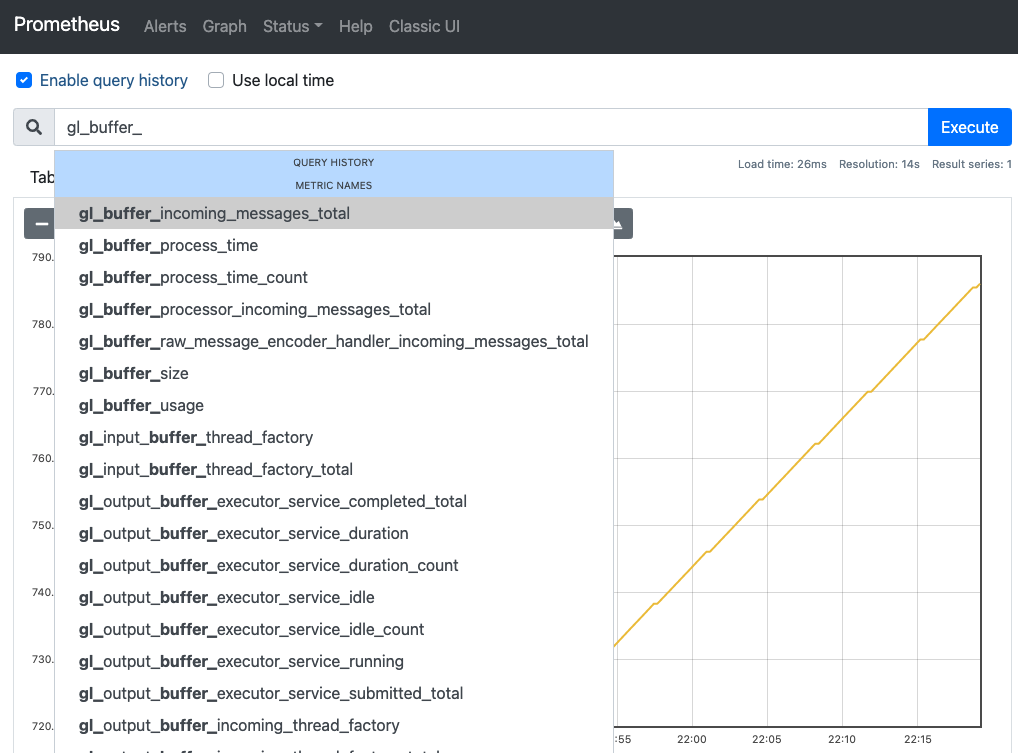

Custom Mappings Example 2
This example mapping produces the gl_buffer_usage metric in Prometheus, which provides the current usage state of the Graylog input, process, and output
buffers.
Note that three separate mappings are provided to consolidate three independent buffer Graylog metrics into a single Prometheus metric with three unique labels (input, process, output) that correspond to each Graylog metric.
The additional_labels property allows for the assignment of an explicit label corresponding to the metric defined in the match_pattern.
Mapping Definition:
Copy
metric_mappings:
  - metric_name: buffer_usage
    match_pattern: org.graylog2.buffers.input.usage
    additional_labels:
      type: input
    match_pattern: org.graylog2.buffers.output.usage
    additional_labels:
      type: output
    match_pattern: org.graylog2.buffers.process.usage
    additional_labels:
      type: process
