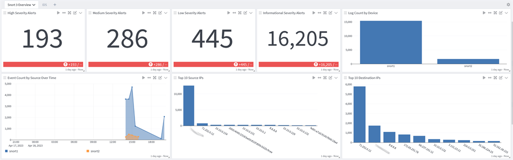

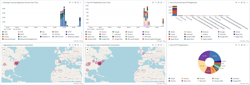

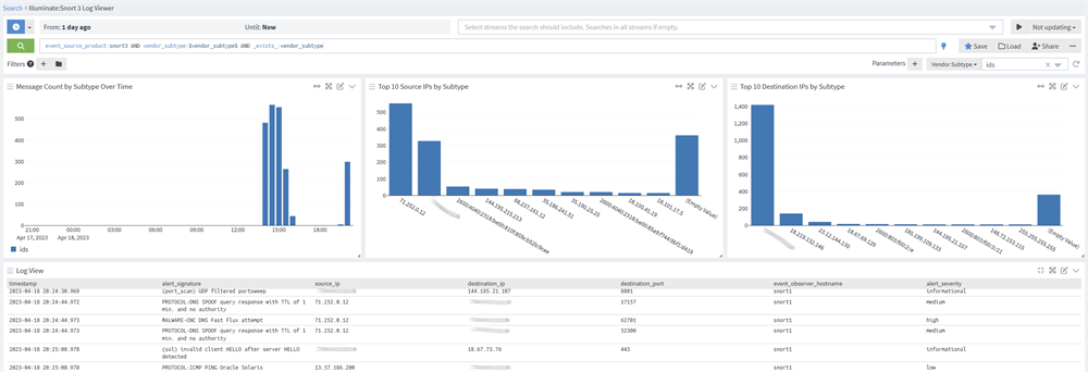

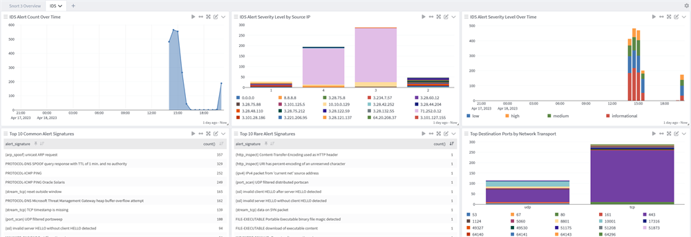

The Snort Spotlight content pack contains two dashboards (Snort 3 IDS Overview, Snort 3 AppID Overview) and a saved search (Snort 3 Log Viewer).
Snort IDS Overview
Snort App ID Overview
Saved Search: Snort 3 Log Viewer
