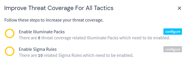

In the next window, you are prompted to review the steps to improve your threat coverage, including:
Enabling specific Illuminate packs.
Enabling Sigma rules.
If any of these steps have not been completed, you can select the configure button next to the requisite step as shown.
                                                        In this example, the latest Illuminate packs have not been enabled. When you select configure, you see a screen that lists the Illuminate packs for the specific technique and you can enable them here.

If you wish to view all the available Sigma rules that can be enabled across the entire MITRE ATT&CK threat field, select the improve coverage button at the top right of the threat coverage widget. Here you can view a comprehensive list of related Sigma rules and enable any additional rules according to your preference.
