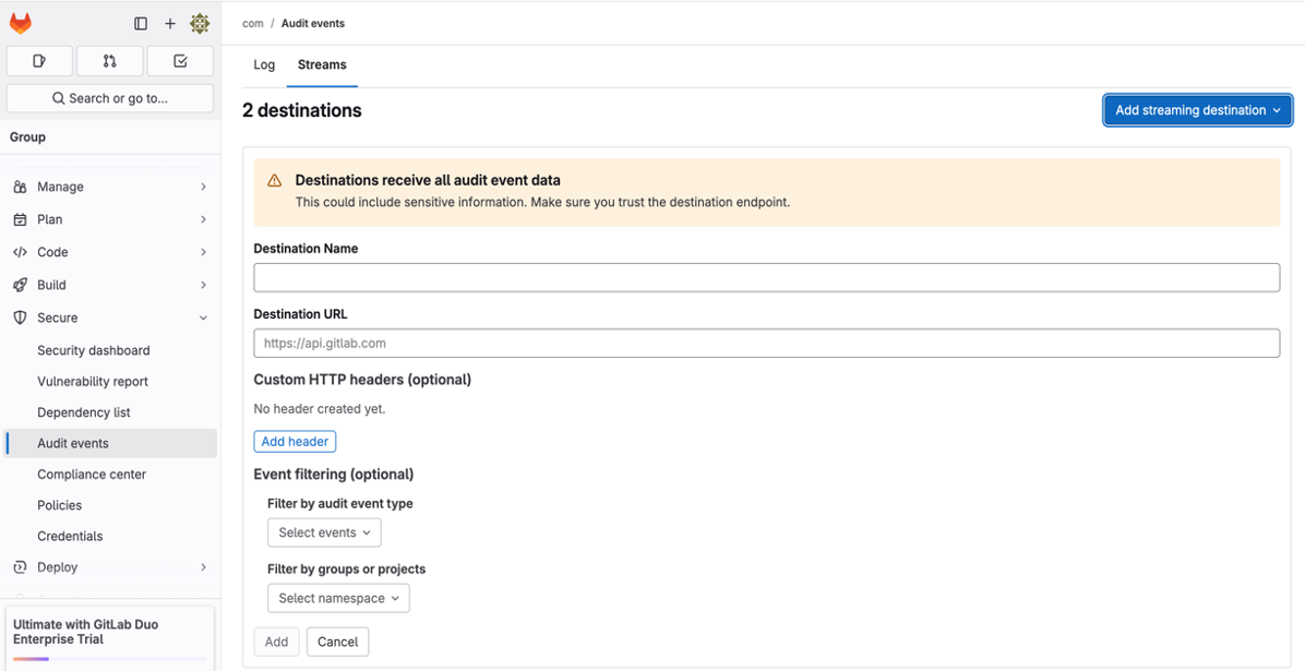

Set Up GitLab Audit Event Streaming
To stream GitLab audit logs into Graylog, several key configuration steps are required. This section outlines the necessary setup for integrating GitLab's Audit Event Streaming with a Graylog instance. It begins with configuring GitLab to forward audit events, followed by specifying the destination details within Graylog, such as the destination name, server URL, and custom HTTP headers. Additionally, optional event filtering can be implemented to tailor which audit logs are captured. See the official GitLab documentation for more information.
Configure the Destination
  • Destination Name: Assign an appropriate destination name.
  • Destination URL: Specify the public-facing host name and port for the Graylog server where the Raw HTTP input running, e.g. https://<graylog-server-hostname>/raw.
  • Custom HTTP Headers: Add a custom header with the same values specified in the input configuration above. Add any additional headers as required by your particular network setup.
  • (Optional) Event Filtering: Determine filters logs to be streamed to the Graylog input.
