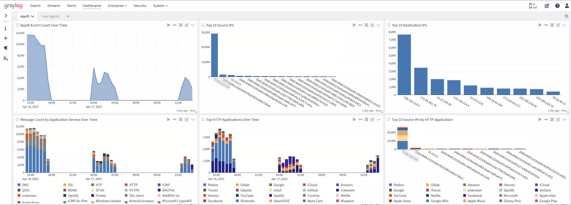

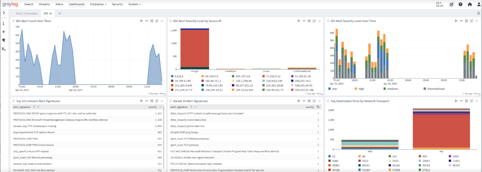

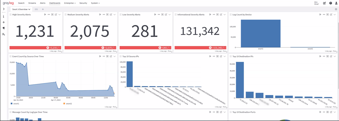

Snort Spotlight Content Pack
The Snort Spotlight content pack contains:
Snort 3 Overview
Snort IDS Overview
Snort App ID Overview
