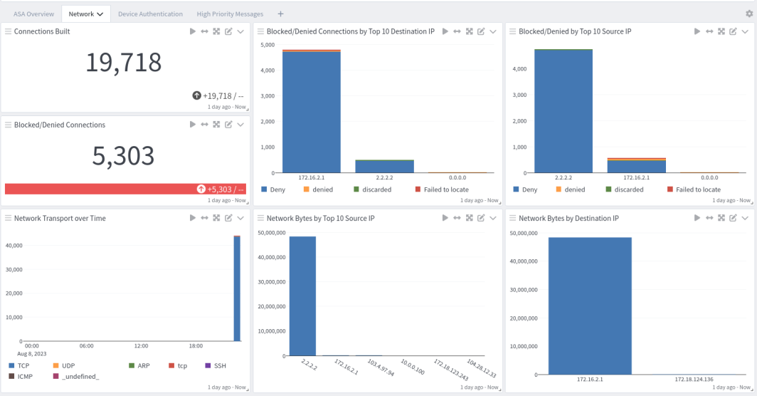

Two dashboards.
One overview dashboard with 4 tabs. These tabs are ASA Overview, Network, Device Authentication, High Priority Messages.

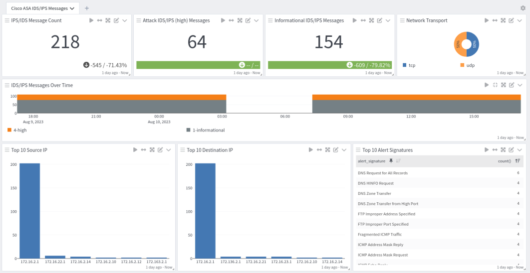

One dashboard for IDS/IPS messages. To get these messages, Cisco ASA may require a specific license.
