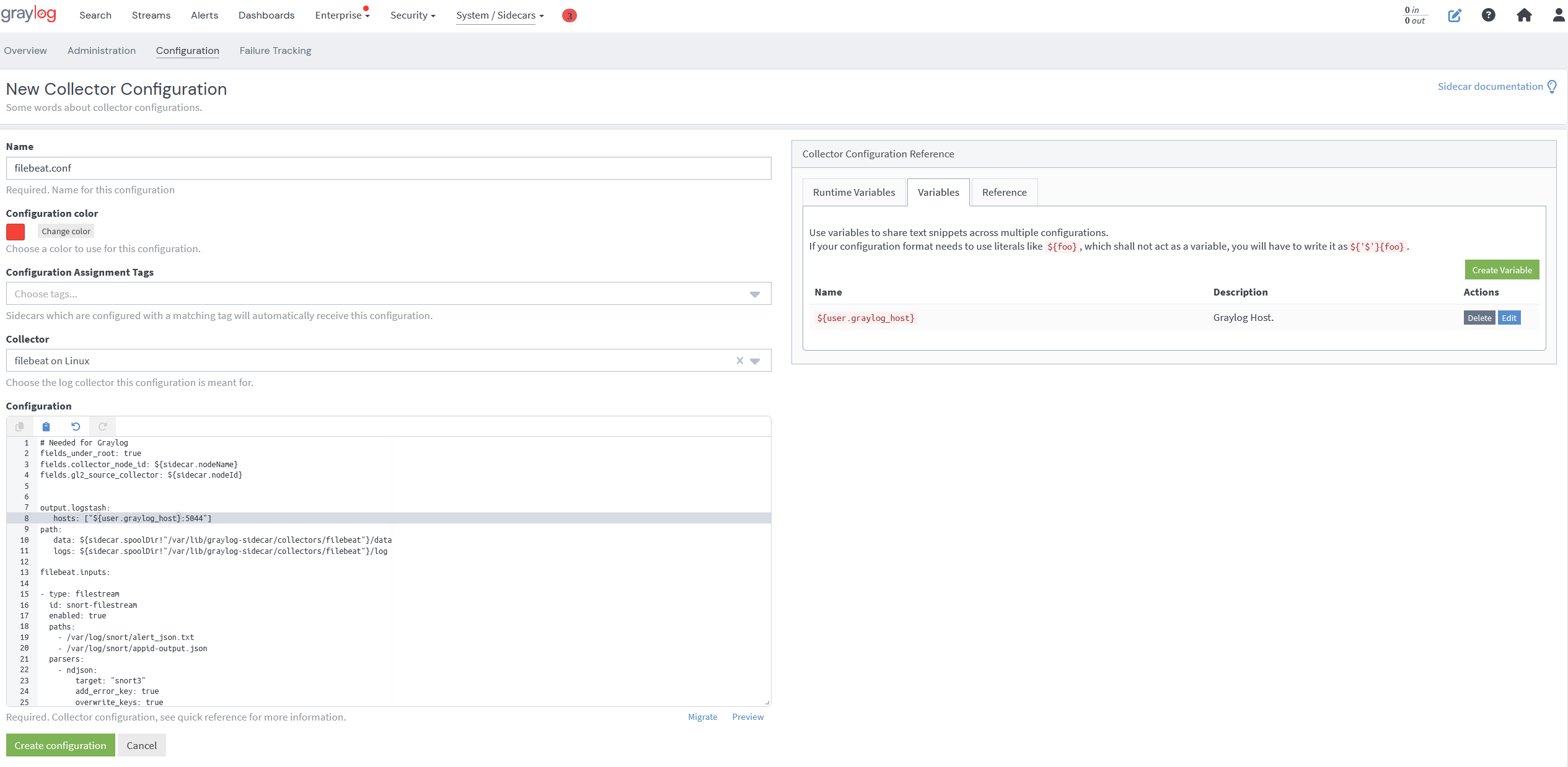

Create and Edit Variables
Configuration variables can contain arbitrary strings, like the IP address of your Graylog server, or the port of an input. These variables can be used in multiple collector configurations. This helps avoid duplication and also simplifies management.
In order to create a configuration variable:
  1. Go to the Collector Configuration page.
  2. Find the Collector Configuration Reference.
  3. Click on Variables and then click on Create Variable.
  4. Enter the necessary content in the modal and click Save.
In the following example, we replace the hard coded IP and port from our Beats input with a new variable named ${user.graylog_host}. First we need to create the variable via the modal on the Collector Configuration page, as explained above. Once we enter the necessary information and click Create Variable, we can now use this variable in all our configurations.
In cases where you need to change the IP or port of your input, you only need to change the variable through the Graylog interface. To do so:
  1. Go to the Collector Configuration page under System>Sidecars.
  2. Find the configuration you need and click Edit.
  3. Go to Variables in the Collector Configuration Reference.
  4. Click the Edit button corresponding to the variable you wish to change.
  5. Edit the information found in the modal.
